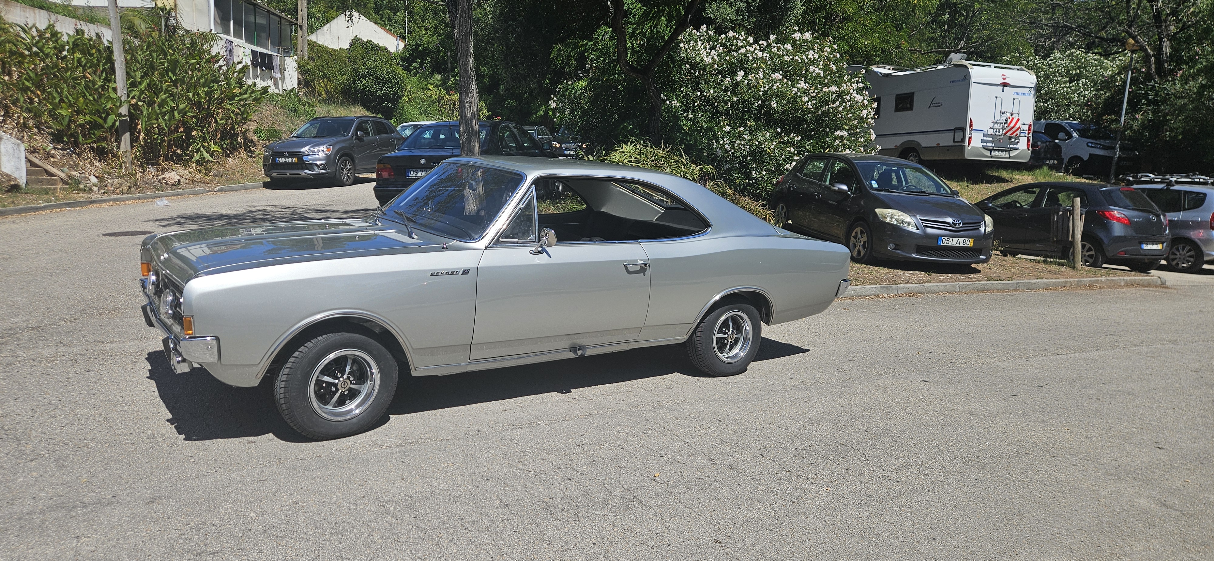

Finally on the streets!
But think that my next battle will be Solex adjustments that are already turning a complete nightmare....
