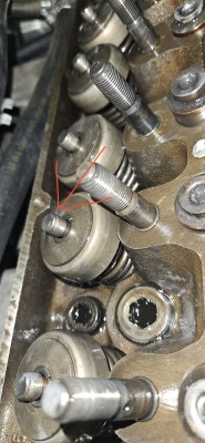

The Topend of the valvestem looks damaged to me, like mangled with a Hammer. I believe that this Surfacequality will damage the new Rockers. :| on the second picture you posted it looks like the hardened plate which is soldered on the Valve is about to leave the valvestem. If that plate drops it will shure crash something.

Brender hat geschrieben: 29.06.2024, 20:48 Unglaublich das das hält? Da ist schon bissl Bums drauf und die Form stimmt ja nicht.
Hast du überall Kappen drauf Tom?
When I saw the photo when I posted it here i thought the same and went to check it out. Again misleading picture. They are fine :wink:
This makes me remember when I replaced my Discovery 2 Td5 head for a brand new AMC head. When I took photos it looked like it was trash :mrgreen: :mrgreen: :mrgreen: :mrgreen: :mrgreen: damm camera phones... :D

yes I know what you´re saying but believe me. It´s not like what it looks. I even thought it was craked when I took the photo and went checking. It´s not like it appears
