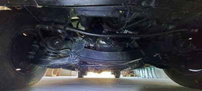

First situation.. Floor pans... All four need to go... Completely rusted out. :shock:
I'll be posting along the way...
Let's begin.... :wink:

Be careful Man, when the Plans are gone its possible that most of the Frames are gone too. And there are no Parts too rebuilt them. Frames maybe, but Original Frames priceless. Without Friends here in Germany, thanks again Mister Buck, theres nothing you can get without pants down.
Although Opel is more or less General Motors Europe, no Spare Parts in a List or Store that are not ridiculous bad on Body Work.
Strip the Body complete, drink a Beer or two and look what you see. Bodywork is lame and maybe it took years with squillions of hours.
My Opinion, i wish you success.
Greetz Metto

The rear part of your car body looks original and good. It is extraordinary that the floor pans are rusted through. This only happens if there has been water in the footwell for a long time or the car has been parked in a damp meadow! Use a screwdriver to test which areas have rusted through. Take lots of pictures and post them. This is the only way we can judge which parts of the body you need!

The heater matrix was leaking all this years. When I turned it on to put in the trailer, water started to fall in the passenger footwell....
If the rest is good, I´ll be sending it to Soda blasting to remove all that horible paint job :D

xpbernardo hat geschrieben: 27.01.2023, 00:22 The heater matrix was leaking all this years. When I turned it on to put in the trailer, water started to fall in the passenger footwell....
hopefully there will still be something left of the bodywork :mrgreen:
What about the front - especially the lamp pots?
There are also repair panels for this, but if you are unlucky, you will have to replace the entire front.
